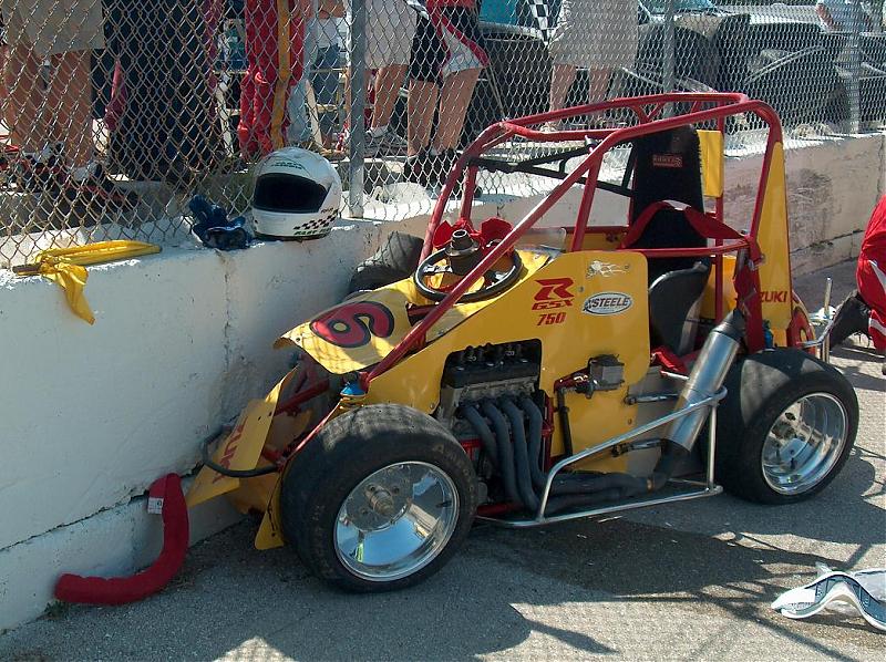

He was going into turn one and his throttle stuck at full speed… hit the wall hard…I talked to Geoff Styner and he gave me this information. Geoff went to the hospital and got first hand information… (thank you Geoff) The drivers name is Fred Stutz and he is 79 YEARS OLD!.. he broke his right shin, hips, and pelvis. Thankfully he brain is clear. He was taken into surgery last night and they removed his spleen and he had a laceration on his bladder. Fred has been coherent and remembers everything… several years ago Fred was badly injured up north and he already has pins in his neck… What a strong man!!! please keep Fred in your prayers …

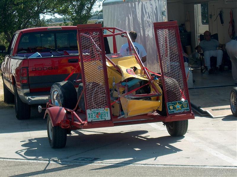

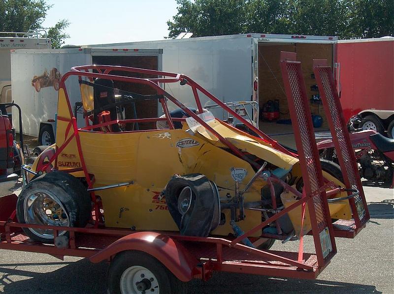

I inspected the car for the family after the incident and my ruling on TQ midgets are the are not strong or large enough for the speeds they can attain. I hope people see the light soon on these cars before more people get hurt.
My heart goes out to Freddy and his family. I was standing about 50 feet from where he hit and the ground shook. I took a few pics. Here is of the car. Its a mess. Oval racer, I have seen hese little cars race for years and have seen them in some preety hairy crashes. For the most part the drivers fared pretty good. They can flip, roll and get tangled up with each other and they are ok. You put one aginst a concrete retaining wall and the don’t do real good. Thanks Bob…
A head on impact with the wall is what killed Howell. After I looked at the car I could not believe that something with the structural integrity of a champ kart would be racing at over 100 mph. I still to this day shake my head when I see them. I don’t even go to tracks when they are racing.
I agree, the bars are 1 1/8 I think. They are pretty small. We had a champ cart hit the wall several weeks ago. He was air-lifted out, but was back at the track a few hours later. Those carts go pretty fast, I’d guess 85 mph or so. Do you think the TQ’s could be made safer by a better cage around the driver. But then they wouldn’t run so fast they’d be heavier. When I saw the crash, the first thing I thought about was his legs being crushed, but he just had an injuried Shin on his leg. Bob…

First off…I race with Freddie. As a driver of a TQ Midget and my own full size sprint car, they are both a safe car. There are no comparisons to a Champ Kart. These are contsructed just like a sprint car, except smaller in size. The car Freddie was in is a smaller Hurricane Chassis, built by the smae man( Stucky). We checked this car over after the crash and found that the cage DID NOT move or bend. Just like any wreck of this sort, his leg injury came from his legs moving around in the car. The cage and saftey equiptment did is job and did it well. That has a very hard hit. Before you go and try to get people from driving or watching a TQ race, you need to do some homework on these cars. The TQ’s that we race are the same TQ’s that run all over the country. Some run wings, some don’t. These cars are built safe and are contructed to run the speeds we run. By the way, how much extra safety equiptment do you use in your poorly constructed mini-stock? We are safer then most Late Model drivers in those cars.

I feel really bad that a racer got hurt. If you read my posts with an open mind and with some intelligence you will see that its not the size of the cage its the weight to speed ratio that I feel gets people hurt in these type cars. By the way I have read about a lot of TQ midget racers being injured seriously since Howells Death. A lot more than I would call an acceptable percentage with todays knowledge of impacts and safety.
