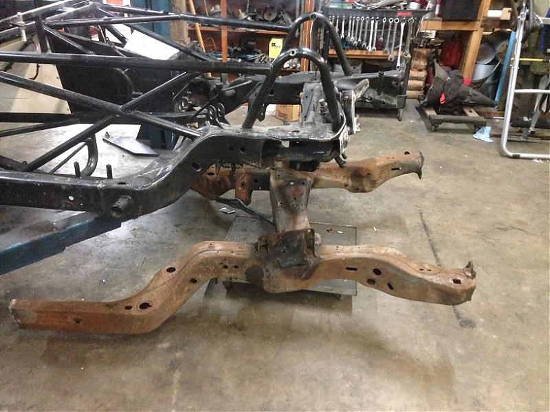

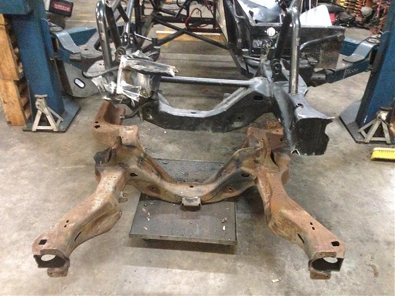

Here we go
have the front clip [ATTACH][/ATTACH]
Dude,
Somebody took your whole darn car apart!
