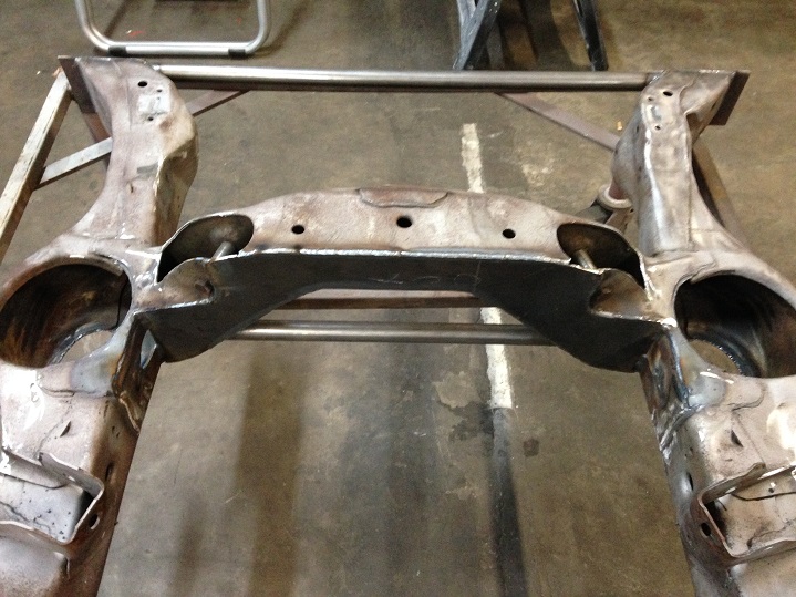

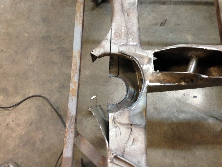

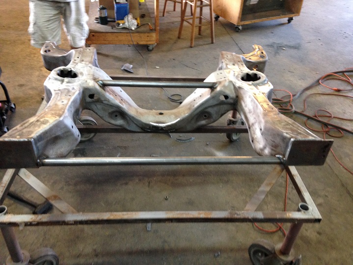

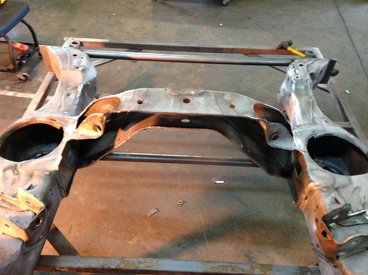

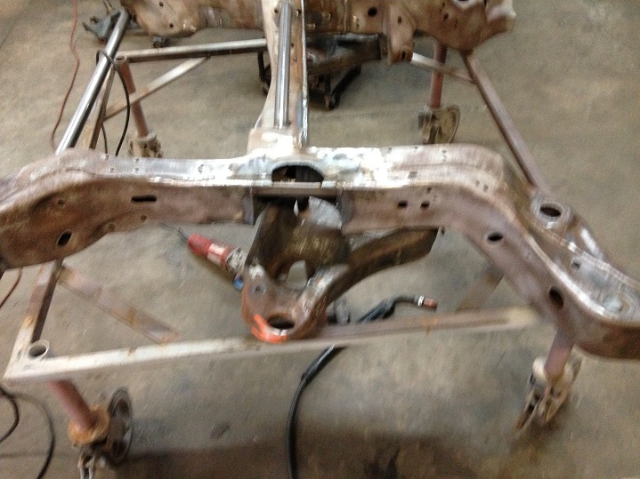

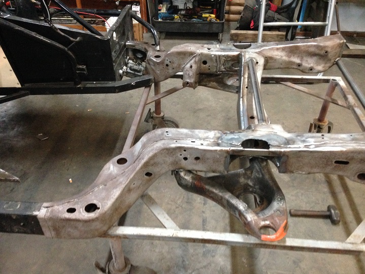

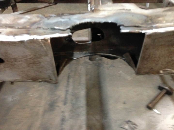

Project stock clip
[ATTACH][ATTACH][ATTACH][/ATTACH][/ATTACH][/ATTACH]

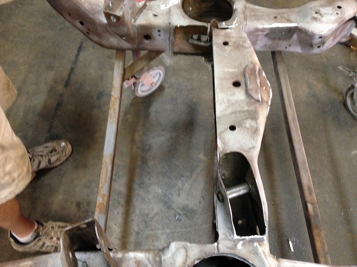

Lots of work

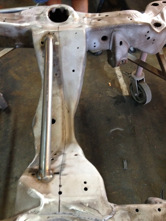

Project stock clip
But it can be done and is all over the country

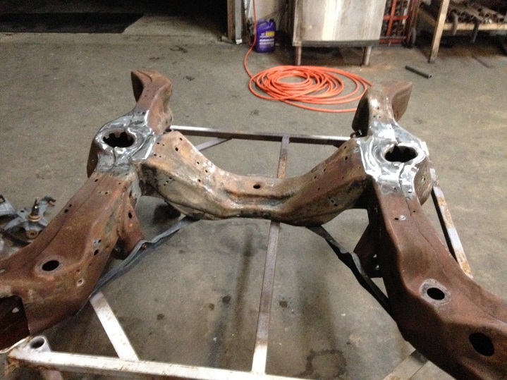

Project stock clip

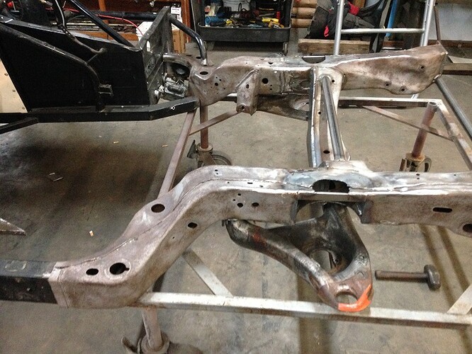

still going
Doug,
A couple of questions:
Why are the outer sides of the frame removed where the springs pass though?
So that the springs can be quickly changed?
Will they later be “plated”? If not, is the frame not compromised, strength wise? I realize it is common practice, though.
Also, the A Frame mounts–while the whole deal is beefy, will you be adding gussets there perpendicular to the mounts back to the frame for strength?
I also realize that weight is the enemy…

Looking good Doug! I’m glad that clip worked for you and it was able to save you a lot of headaches. I just finished sanding and painting so I should be putting the suspension on soon so I can start running wires and brake lines.
Mark
Cool Mark…Thanks again

[QUOTE=OldSchool+;167585]Doug,
I also realize that weight is the enemy…[/QUOTE]
Shock clearance and ease of spring removal…and no gussets on lower. Keep in mind im no professional. But i watched a video once.
