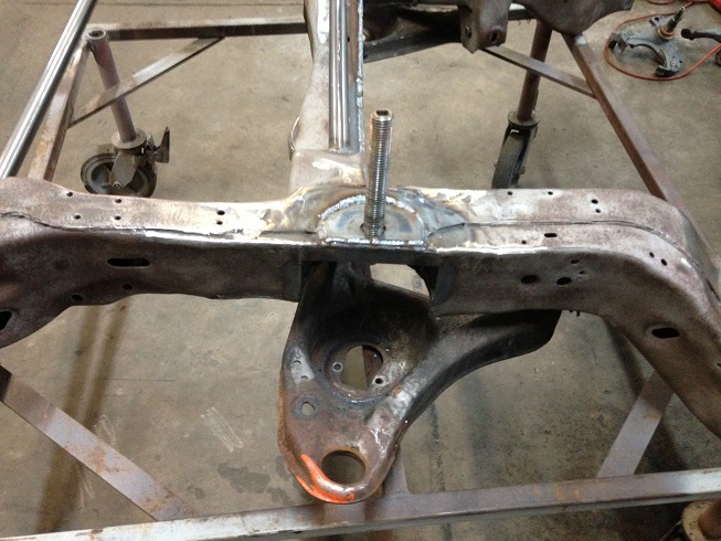

Doug, looks good man, you do nice work, great job man. I know you are busy but can you tell me the dimension differences of the GM bottom A arm to the Ford. I ask that question before and never got a answer, I wanted to put on Ford arms on our Ellis so I could get away from those 1 inch offset wheels on the right side that we have to use to get the 78 in width. Just curous if the Ford arm will mount into the Ellis chevelle clip??

It should bolt right in and I believe it is 1 3/8" longer from frame to ball joint.

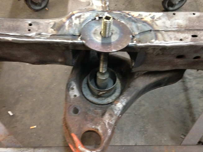

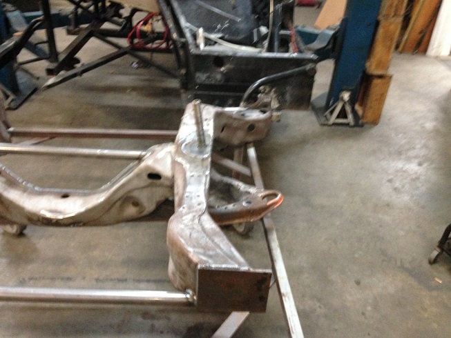

One thing that I will tell you is that stock frames are still available especially down here. I am proving that it can still be done. That is the only reason i have posted my stuff on here. In a previous post I showed that most every major car builder is only selling stock clip cars.
Oldschool…I dont think I made the wrong choice and will continue to be a pain in tech mans side as long as it needs to happen. I plan on showing the mod guys that a stock clips can get it done.
After all the research and all the things I have dug into it is clear that there should never been a fab clip introduced in our class. But if you run them they should get a weight penalty and the bolt height from cross member should be 3 1/2" no exceptions.

If I dedicated 100% of my time it could happen in 5 or 6 days I guess. It depends on a lot of things. Unfortunately for me there is work and then family. The wife doesnt understand the long hours at the shop.
  1. If you have to strip a entire car to get the clip
  2. Degrease
  3. Sandblast
  4. cut chop prep
  5. fit to exact measurements
  6. weld,weld,weld
  7. Depends on how many bolt on parts are destroyed…steering ,gearbox, motor mounts, In my case the gear box drove the steering shaft into my header and broke the quickner in half
  8. paint
  9. set up
There are lots of variables. The fab clip eliminates alot of this hard work. or if you have plenty of money to drop it off and pick it up (not in my case).
I dont really have a problem with Fab clips as long as they are one type across the board. One set of measurements for all cars… They were never policed and as I stated before no cars were turned away. people exploited the gray area…period
